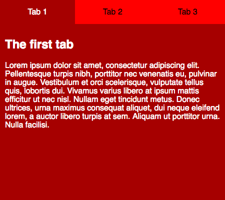

Hiding things
There are many instances where a visual design will require that not all content is shown at once. For example, in our Tabbed info box example (see source code) we have three panels of information, but we are positioning them on top of one another and providing tabs that can be clicked to show each one (it is also keyboard accessible — you can alternatively use Tab and Enter/Return to select them).
Three tab interface with Tab 1 selected and only its contents are displayed. The contents of other tabs are hidden. If a tab is selected, then it's text-color changes from black to white and the background-color changes from orange-red to saddle brown.
Screen reader users don't care about any of this — they are happy with the content as long as the source order makes sense, and they can get to it all. Absolute positioning (as used in this example) is generally seen as one of the best mechanisms of hiding content for visual effect because it doesn't stop screen readers from getting to it.
On the other hand, you shouldn't use visibility: hidden or display: none, because they do hide content from screen readers. Unless of course, there is a good reason why you want this content to be hidden from screen readers.
